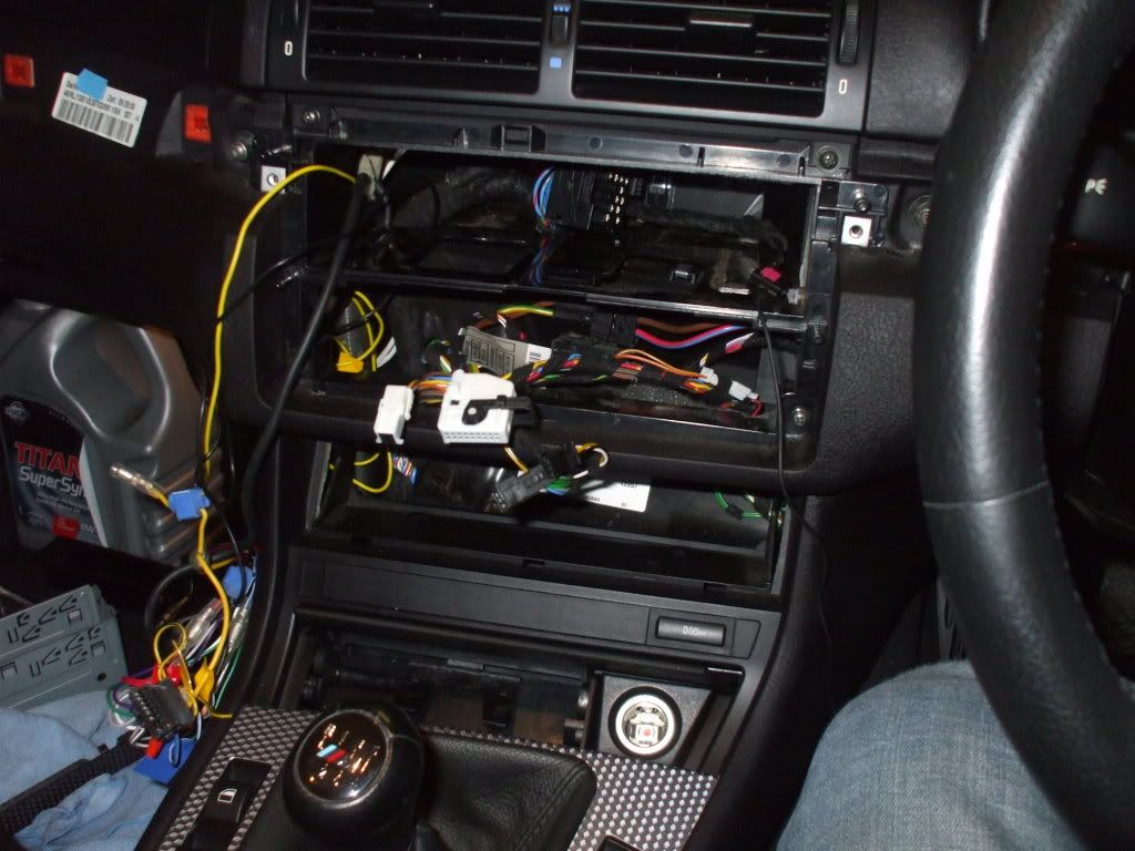

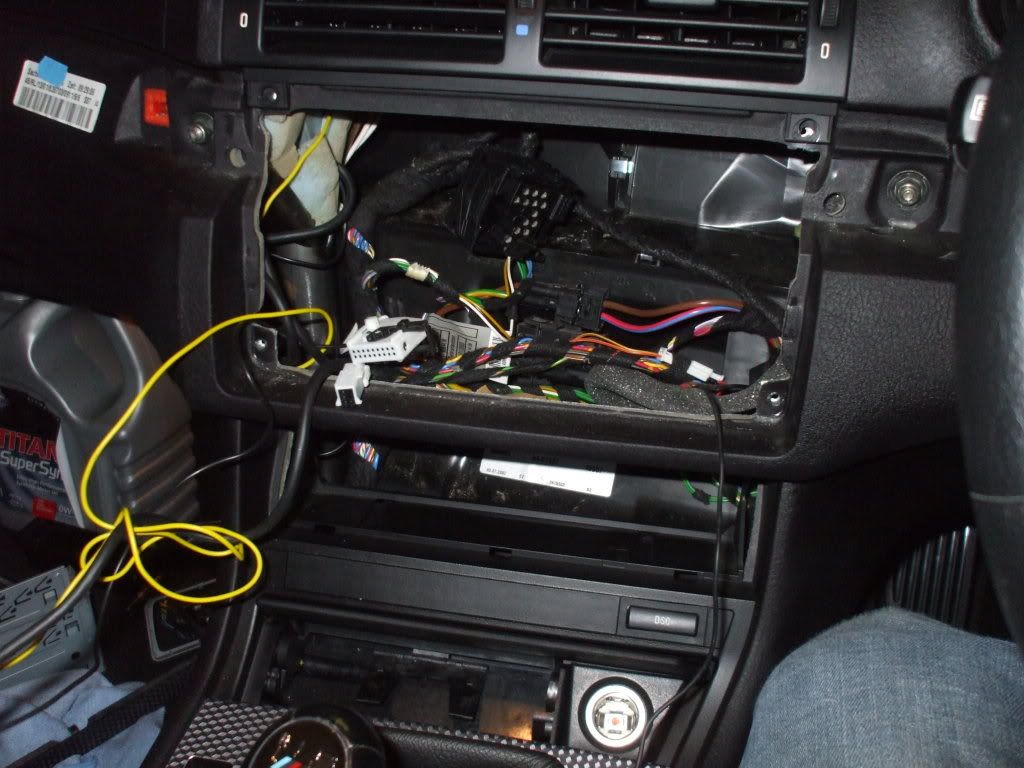

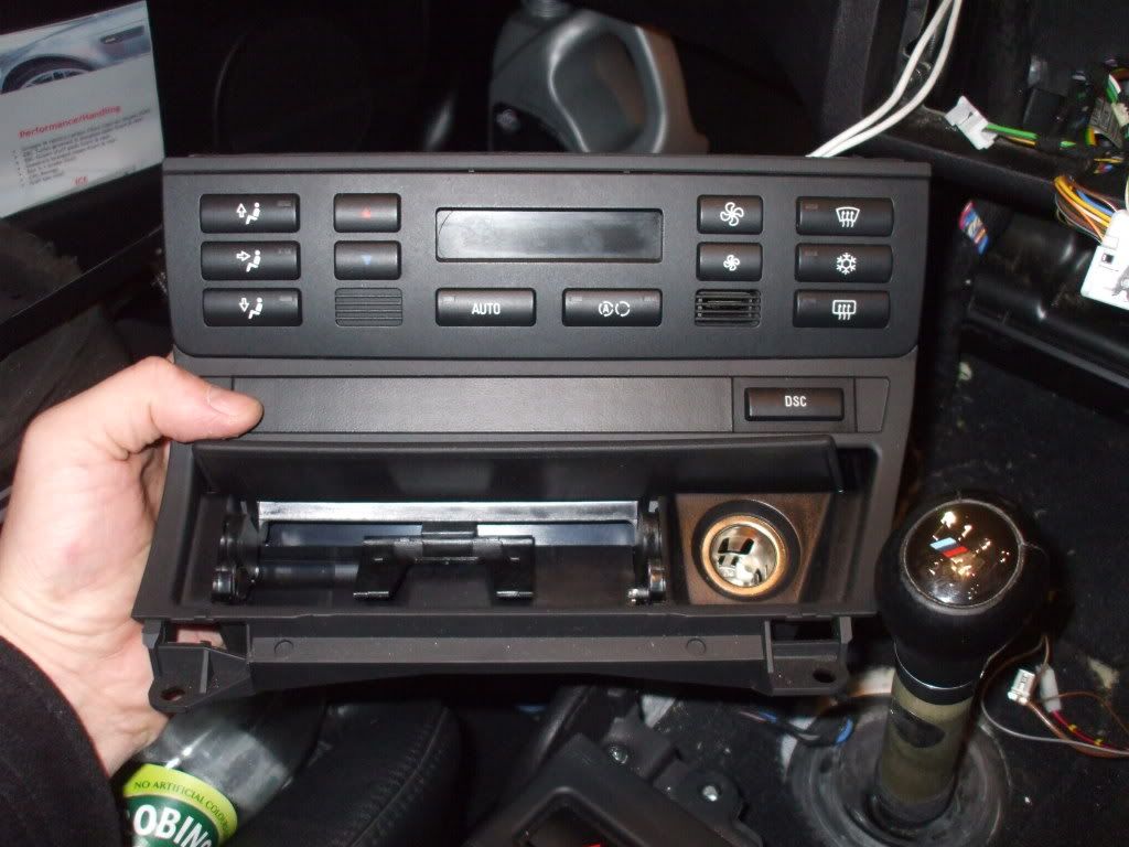

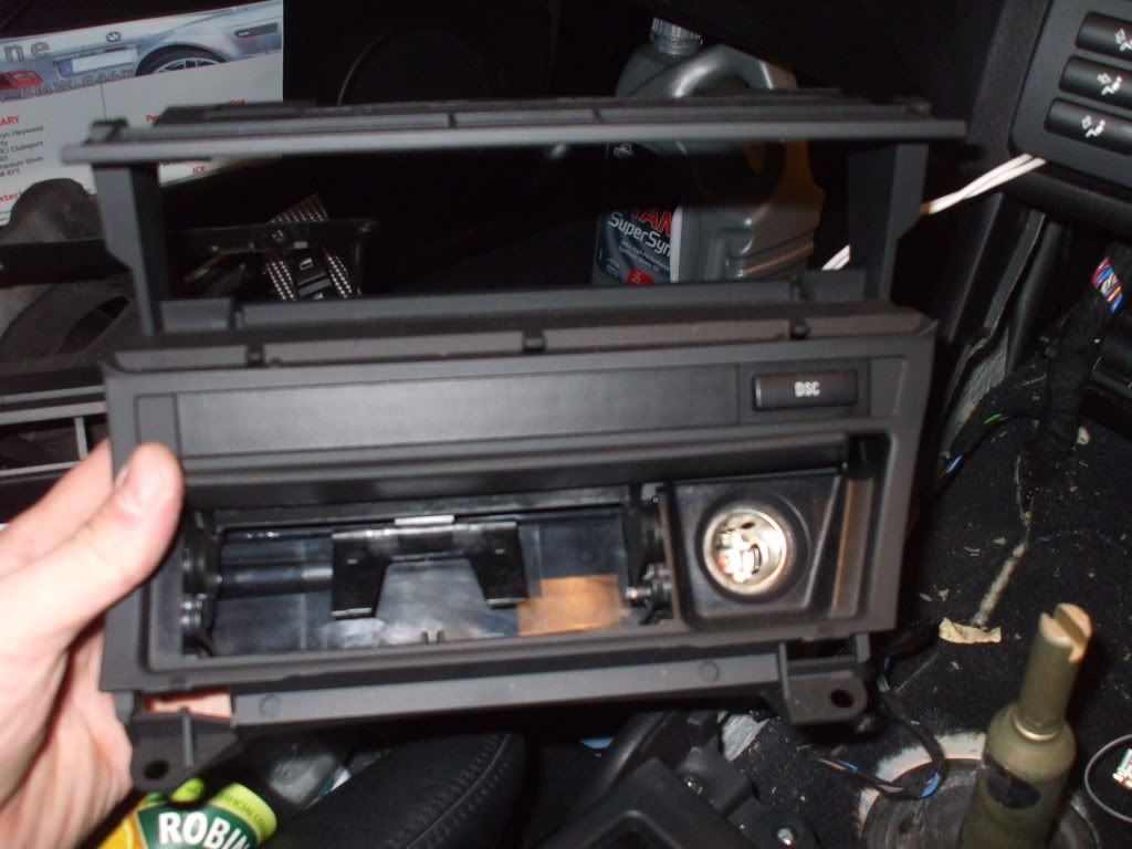

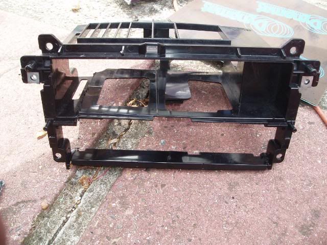

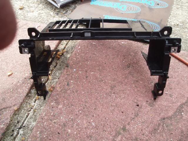

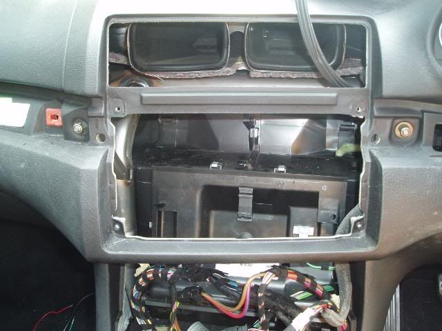

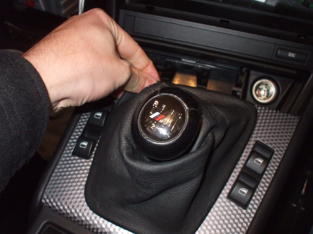

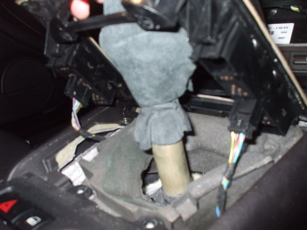

///Marty Posted October 29, 2008 Report Share Posted October 29, 2008 Thought i'd get a start on this one, As pretty much all the bits have arrived now and it'd be nice to try and at least get the HU in before the bluwater meet. Started this evening by stripping down the centre console. Gonna try and take loads of pics all the way through the process, and will just add to the thread as and when i've got time to do a bit on it. First things first. Removed my Pioneer single din head unit: Next up i removed the sunglasses holder (just get your hand inside and give it a tug), and removed the air con unit by pushing it out from behind and disconnecting the four wires that connect it to the car: With the air con unit out the way, the carrier for the HU and the air con can be removed - four screws top and bottom in each corner: Next i needed to remove the bottom carrier that houses the sunglasses holder, ash tray and cigarette lighter. To remove this the gear surround needs to be removed as two of the four screws are located underneath. Pop the gaitor off (i found it easiest to start at one corner and work the rest out, and remove the handle by giving it a good pull! - try not to hit yourself in the face or knock your interior mirror off at this point as when it goes.... it really goes! Lift up the surround, disconnect all the window switches and the whole thing will lift up and will be out of your way: Remove the four screws from the lower carrier and disconnect the wires from the back of the cigarette lighter and this can no also be removed: The DSC button, fill panel, ash tray LED and cigarette lighter can now be removed from the old carrier and placed into your new air con relocation unit (£30 from quarry motors). Air con unit can now be fitted into new lower carrier which leaves a nice big hole for lovely double dininess at the top!: Link to comment Share on other sites More sharing options...

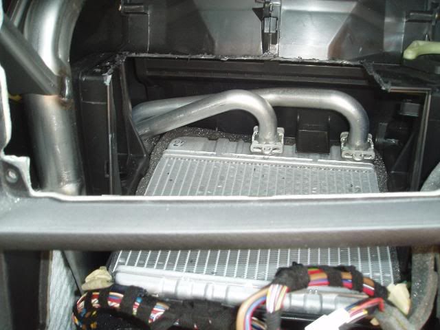

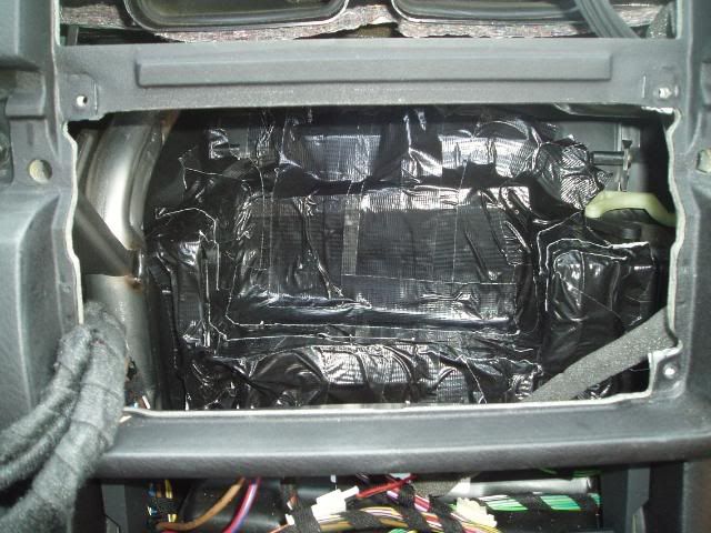

Dicky Posted November 6, 2008 Report Share Posted November 6, 2008 Marty Not sure if you have cut your heater box yet but thought I would stick these up to give you some pointers if not I will edit them out at the end of so it keeps your DIY nice and tidy Before After I will try and find time to get my full write up for this done it just takes so long and I have been a bit busy lately Link to comment Share on other sites More sharing options...
simonlpearce Posted November 6, 2008 Report Share Posted November 6, 2008 Thats some extreme work, could be a little daunting if you didnt know exactly what your doing! Link to comment Share on other sites More sharing options...
Jonny Posted November 6, 2008 Report Share Posted November 6, 2008 Jesus thats brave dicky! Link to comment Share on other sites More sharing options...
Dicky Posted November 6, 2008 Report Share Posted November 6, 2008 Yeah it can be a bit scary but it is so worth it in the end I couldn't find much on this when I started for RHD cars but figured as my previous job was in car audio I thought I should be alright as I have done far worse to customers cars Link to comment Share on other sites More sharing options...
DaveDunlop Posted November 6, 2008 Report Share Posted November 6, 2008 right im def coming round to yours when i do this dicky, plus if it goes wrong i can blame u lol not sure i can be so 'dremel happy' on my car! Link to comment Share on other sites More sharing options...
stealth05 Posted November 6, 2008 Report Share Posted November 6, 2008 Marty Not sure if you have cut your heater box yet but thought I would stick these up to give you some pointers if not I will edit them out at the end of so it keeps your DIY nice and tidy Before After I will try and find time to get my full write up for this done it just takes so long and I have been a bit busy lately scary does this effect your heater air con in any way Link to comment Share on other sites More sharing options...
