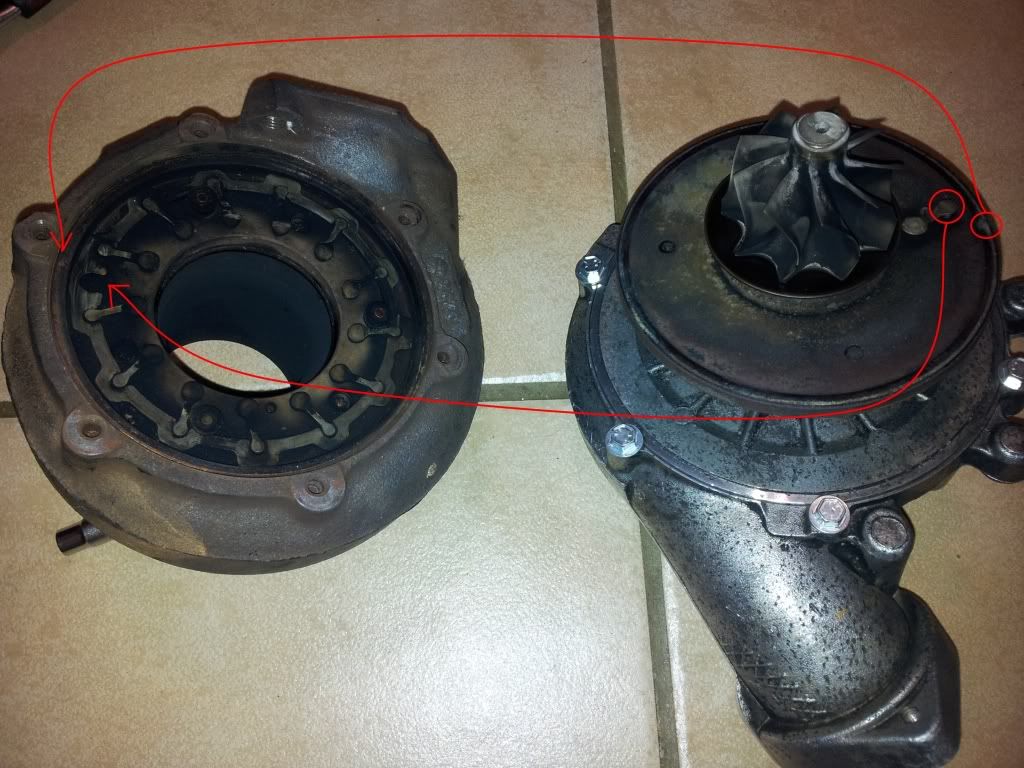

StuBeeDoo Posted February 2, 2014 Report Share Posted February 2, 2014 (edited) Cleaning with Mr Muscle requires it to be directly squirted in the exhaust side of the turbo to prevent any seals etc being destroyed, reading the Audi forum they removed the egr pipe which lead directly into the exhaust side of the turbo.... I think we'd have to remove the turbo to do it wouldn't we as the EGR isn't directly next to the turbo?? **edit** just had a quick look at the above linked and again the egr pipe leads in right above the turbo, I can't see how we could do it without removing the turbo... Agreed. I had a look through all the stuff I could find on VAG engines, and (like Fords, IIRC) they have their EGRs on the exhaust side, not the inlet side. Maybe you could do it by dropping the downpipe off and squirting directly into the turbo?? It would save some of the hassle of removing the turbo fully but then with it removed you could remove the VNT assembly and give it a good soak and see what's what I'm not so sure about this one. As I understand it you need to get the cleaner to sit on the vanes. That would need the cleaner to be introduced from the engine side of the turbo. I can't see any way of doing it without having the turbo off. As always, if someone knows better I'm prepared to eat humble pie. PERSONALLY ....... I think the only solution to avoiding,or freeing-off, sticky vanes is to either use premium fuel or add regular doses of something like Forte Diesel Turbo Cleaner. I use supermarket fuel so I think I'm going to weigh-up the pros and cons of additives against V-Power (the only premium fuel I'd use). Edited February 2, 2014 by StuBeeDoo Link to comment Share on other sites More sharing options...
TriggerFish Posted February 2, 2014 Author Report Share Posted February 2, 2014 Ive never heard of sticky VNTs on these, id guess because the electronic actuators are more manly than the traditional VAG ones. Also to point out Im pretty sure these are the same turbos as the 150bhp ARL VAG engines and they didnt have VNT issues so much due to more vanes, it was the smaller turbos with less vanes that had the issues mainly. I cleaned my turbo when I had it off the car but not sure how easily you could get access to it, as mentioned above. Id also say if its hard to push the actuator rod thats not necessarily a bad thing either. I'm pretty sure my ARL didn't run a gt22** series? People also upgrade to these, so they mist be bigger than stock. Maybe the 320d shares though? I'm not willing to take it off the car, but it really doesn't seem doable after seeing that manifold photo. Oh well, was only a 'because I can' type thing anyway. Cheers for the help though guys! Link to comment Share on other sites More sharing options...
StuBeeDoo Posted February 2, 2014 Report Share Posted February 2, 2014 (edited) I'm not willing to take it off the car, but it really doesn't seem doable after seeing that manifold photo. Oh well, was only a 'because I can' type thing anyway. Cheers for the help though guys! Dude, if you think you might have a vane issue, try giving the Forte stuff a go. See here It says it can free them off............. Edited February 2, 2014 by StuBeeDoo TriggerFish 1 Link to comment Share on other sites More sharing options...
