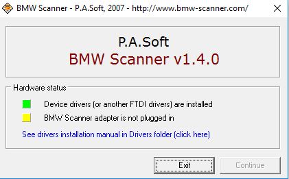

Robotson Posted February 18, 2017 Report Share Posted February 18, 2017 I've just installed the demo version of PA Soft BMW Scanner 1.4.0 on my windows 10 laptop (and ran with compatibility mode for Windows 7), and the program opens and seems to work ok. But then when I connect the OBDII dongle to the laptop by USB, turn on the ignition, and click 'Car Ident', I get a 'Hardware not ready' error. I've tried all ignition levels, and different USB ports, and tried starting the program as administrator.. but nothing works. @dontpannic do you have any idea maybe? Cheers for any help! Link to comment Share on other sites More sharing options...

dontpannic Posted February 20, 2017 Report Share Posted February 20, 2017 More than anything that looks like a driver issue if anything. Are the drivers for the cable installed properly and detected within Device Manager? I'll be honest, my machine is a Mac. I run Windows XP SP4 (unofficial) with no network connection in a Virtualbox VM and tell it to pass the USB connection through to the VM. Most of this software works with XP with no problem at all. I saw someone mention the .net framework up above. 4.0 is backwards compatible with 3.5. The only ones you need to install are .net 1.1, .net 2.0 and .net 4.0. You can install 1.1 or 2.0 after 4.0, it doesn't overwrite. Robotson 1 Link to comment Share on other sites More sharing options...
Robotson Posted February 20, 2017 Author Report Share Posted February 20, 2017 9 hours ago, dontpannic said: More than anything that looks like a driver issue if anything. Are the drivers for the cable installed properly and detected within Device Manager? I'll be honest, my machine is a Mac. I run Windows XP SP4 (unofficial) with no network connection in a Virtualbox VM and tell it to pass the USB connection through to the VM. Most of this software works with XP with no problem at all. I saw someone mention the .net framework up above. 4.0 is backwards compatible with 3.5. The only ones you need to install are .net 1.1, .net 2.0 and .net 4.0. You can install 1.1 or 2.0 after 4.0, it doesn't overwrite. I'm not sure about the driver.. can't remember if it was there in Device Manager. My laptop's DVD drive appears to have died, so I've had to install the demo version of PA Soft instead, not sure if that would be the same thing or not. However, I've given up on PA Soft and installed the Oracle VBox with XP Pro running - which works great I tried installing PA Soft on that too, but I get a different error when trying to run it on XP - something about a CRC error? I've now installed 'Mike's Easy BMW Tools Package' on XP which contains all of the following: - Inpa 5.0.6 (with English script files & Support for F-series) - EDIABAS 7.3.0 - NCS Expert 4.0.1 (with English menus and buttons, and NCS Dummy Profile pre-installed) - NCS Dummy 0.6.0.4 - Tool32 4.0.3 - WinKFP 5.3.1 - Integrated SP-DATEN v53.3 - BMW Coding Tool v2.5.0 (for use as an alternative to NCS Dummy, or to update DATEN files as new ones become available) - USB Drivers for cable So I presume I can code the car (and primarily my new Xenons when they arrive) with some of these tools, NCS Expert/Dummy or BMW Coding Tool? In other news, some **** knocked the rear of my car over the weekend, cracking the paint on the bumper and bending the plastic slightly. It's going into the bodyshop for £1100 worth of respray tomorrow.. which DIDN'T include the rear bumper. Typical! Link to comment Share on other sites More sharing options...
Robotson Posted February 20, 2017 Author Report Share Posted February 20, 2017 This is the error I get in XP when running PA Soft Link to comment Share on other sites More sharing options...
Robotson Posted February 20, 2017 Author Report Share Posted February 20, 2017 Update.. I can't get any of the tools in the Mike Easy BMW tool kit to recognise the dongle. Perhaps because its a specific PA Soft dongle? Managed to install the BMW Scanner 1.4 drivers on XP properly.. but I'm still getting that CRC Error above. Very frustrating. Link to comment Share on other sites More sharing options...
