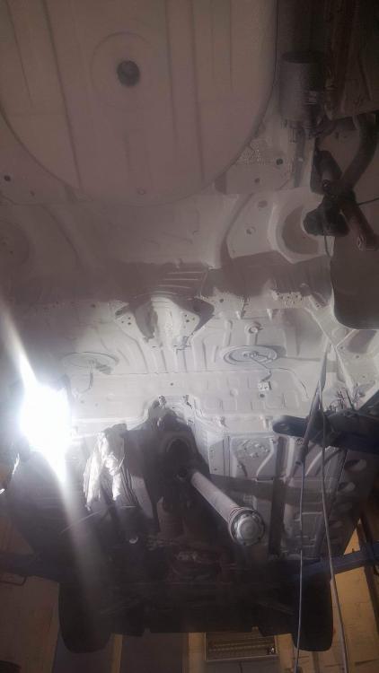

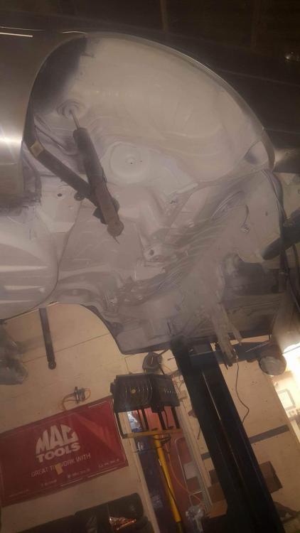

Dirty Tool Posted July 7, 2008 Report Share Posted July 7, 2008 My first post here and unfortunately not a positive one: This is the current stage on my 2000 328ci. Link to comment Share on other sites More sharing options...
Sam Posted July 7, 2008 Author Report Share Posted July 7, 2008 My first post here and unfortunately not a positive one: This is the current stage on my 2000 328ci. Take it to BMW complaining of a loose back end etc. They should tell you its the subframe and offer to fix 100%. thats what happened to me. If they blame something else, drop a hint your local mechanic said its the sub frame.Then argue it for free! Good luck Link to comment Share on other sites More sharing options...
muly Posted July 7, 2008 Report Share Posted July 7, 2008 As i said on e36coupe , let us know what the dealer says and does about the situation, and welcome to the forum Link to comment Share on other sites More sharing options...
Dirty Tool Posted July 7, 2008 Report Share Posted July 7, 2008 thanks guys - well i spoke to BMW GB and they said to book it in at my local BMW garage so done that. Still have to pay a diagnostic fee but if BMW decide to foot the bill I will get the money back. Fingers crossed! Link to comment Share on other sites More sharing options...
