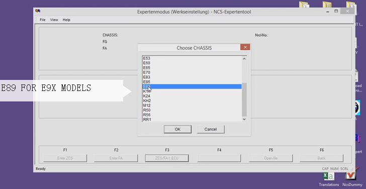

select CHASSIS: E89 for E9x models
select chassis e89

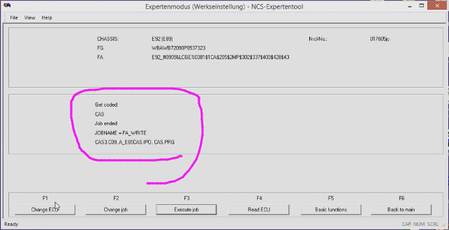

select ECU: CAS
press CHANGE JOB to: FA_WRITE)
check for FA_WRITE and EXCUTE JOB
FA-Write

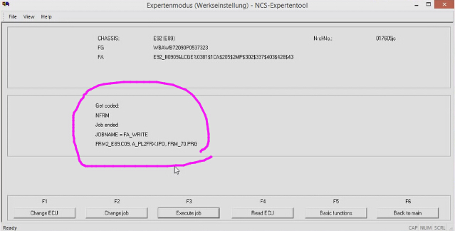

press CHANGE ECU
select ECU: NFRM
note: FRM module or NFRM depending on model
EXCUTE JOB again to make sure FA_WRITE and correct module selected
excute job

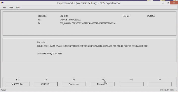

press BACK
process ecu
press PROCESS ECU
select ECU: CIC
note:
CIC now should be displayed in the list of modules
select cic

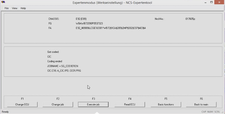

press CHANGE JOB to make sure that SG-CODEREN is selected by JOBNAME
SG-CODEREN
check and press EXCUTE JOB
the CIC unit will reboot and load up with all of your options
cic reboot
