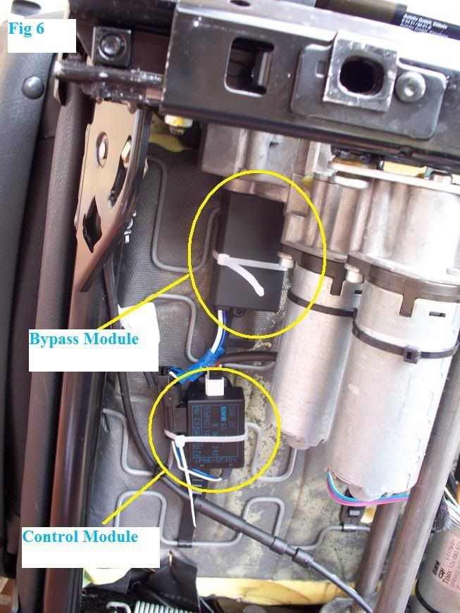

Aly Posted February 18, 2010 Report Share Posted February 18, 2010 (edited) EDIT: I also feel the need to mention something that I came across on another forum! An eBay member is selling these so called units but are made extremely badly.. I believe It's the same seller using my pictures in previous auctions.. Here are a couple of links... http://forum.bmw5.co...393#entry674393 http://forum.e46fana...44#post14175944 The seller in question is... airbagmodules & a3_thr I hope that it's okay to do this, but feel the need to warn the public of this... I would however recommend http://www.ebay.co.uk/itm/330695789403 Hi all... Just thought I would do a little DIY on this. Although its very easy to do... If you've had this problem you'll know how annoying it is to have a warning light on your dash! With this DIY I hope it will eliminate the dredded SRS Passenger seat Occupancy sensor. Firstly make sure you've had a diagnosis done to determine that this is the actuall problem/fault. Replacing the occupancy sensor mat is very costly and time consuming. But you can buy these Occupancy Sensor Bypass kits on E-Bay for less than £20. This is the kit. FIG 1 CAUTION - Do not fit to vehicles that carry a child seat in the front passenger seat Tools required 1. Crimp Tool. 2. 2 zip ties. 3. 10mm Spanner or Socket (to disconnnect battery) For the puropse of the DIY I removed the passenger seat, however this can be easily done without doing so. 1. Disconnect battery, using 10mm spanner/socket and leave to stand for 10 minutes. 2. Locate the Occupancy sensor control module under the passenger seat. This can be found towards the rear of the seat. Please see FIG 2 3. Unclip the control Module and lower to the floor giving better access to the black mulitplug. 4. Cut the Occupancy sensor wires just before they disappear into the seat base. Please see FIG 3 5. Strip the ends of the blue and white wires. Please see FIG 4 6. Now connect your new bypass module to the corresponding wires using the connectors and crimp tool. Please see fig 5 7. Re-connect the black multiplug (now with the bypass module attached) to the occupancy sensor module, and re-attach the control module to the seat and fasten the bypass module using the cable ties. Please see FIG 6 8. Re-connect the battery using the 10mm spanner/socket. 9. You may need to clear the SRS code using a compatiable diagnostic equipment. (however I did not have to do this), and hey presto the light should disappear. Please see FIG 7 Hope this helps Property of Aly® Edited April 14, 2012 by Aly Ascorpionze 1 Link to comment Share on other sites More sharing options...

dino Posted February 21, 2010 Report Share Posted February 21, 2010 I have this error light on occasionally... Does the bypass unit fool the car into thinking someone is in the seat all the time then? Link to comment Share on other sites More sharing options...
Aly Posted February 24, 2010 Author Report Share Posted February 24, 2010 I have this error light on occasionally... Does the bypass unit fool the car into thinking someone is in the seat all the time then? Yip pretty much! Link to comment Share on other sites More sharing options...

philgrady Posted April 11, 2010 Report Share Posted April 11, 2010 Hi everyone, just carried out the above, but with one change, here is a circuit from the net to make your own bypass module. The parts cost me £0.50 from maplin and a bit of solder and wire. I installed it and then reset the airbag light and hey presto, the light is gone. Circuit diagram attached Link to comment Share on other sites More sharing options...
Fahim-mo Posted July 25, 2010 Report Share Posted July 25, 2010 If you are afraid like me of cutting wires then you can do what I did. I bought this from an Ebay seller in Germany: It's simply plug and play. After I plugged it in I had to get my airbag light reset by my garage. Cost of module was £11 including postage from Germany. My mechanic charged me £15 to reset the error codes. If interested the ebay seller was this guy: ebay link The listings are all in German language but I simply used yahoo babelfish translator to work out what everything said. Shop around though because for some reason the price has gone up. Link to comment Share on other sites More sharing options...
