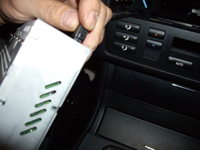

Bandad Posted April 1, 2010 Report Share Posted April 1, 2010 Brilliant DIY write up Delmarco I have just installed this in my (new to me) 330 ci convertible. There were only three problems: getting the air vents out took more courage and effort than expected - in spite of notes on here removing the exiting Nokia kit that had been poorly fitted and didn't mute the radio. They had cut into the wiring harness to the back of the radio and made some very dodgy connections. working out the the ignition key had to be in position 2 before the steering wheel controls worked. Minor panic on that one. Rain stopped play so fitting the mic and re-fitting the glove box will have to wait. I have managed to remove the central lighting rig easily and there is a position for the mic. Just need some dry weather so I can flip the roof and run the wires up. Now need a new trim panel where the Nokia button was glued on. Link to comment Share on other sites More sharing options...
scrimja Posted April 1, 2010 Report Share Posted April 1, 2010 I still have nightmares about getting those vents out! There MUST a knack to it but I don't know what it is lol. I Think I was the one that posted about a bodge job installation of a nokia kit earlier in the thread. I just taped mine up. Didn't want to start making even more of a bodge job on the removal lol! Make sure you don't have any screws left over from the glove box like I did lol. Oh and my blue box didn't fit where Del Marco put his so keep that in mind if you find your glove box won't go back in. Took a bit of head scratching before I worked out it was that when my g'box wouldn't fit back in! Link to comment Share on other sites More sharing options...
Bandad Posted April 1, 2010 Report Share Posted April 1, 2010 Oh and my blue box didn't fit where Del Marco put his so keep that in mind if you find your glove box won't go back in. Took a bit of head scratching before I worked out it was that when my g'box wouldn't fit back in! Neither did mine (fit). I taped it up on the side panel. Hopefully it won't start rattling. The mic is in place now. Really tidy - you can't see it - but reportedly sounding a little distant. I will take some more opinions before I bother adjusting it. Overall I'm delighted. Link to comment Share on other sites More sharing options...
scrimja Posted April 1, 2010 Report Share Posted April 1, 2010 Mine is just loose in there somewhere and it doesn't rattle so it should be fine. My mic is sat behind the rear view mirror, can't see it and people can hear me just fine! Link to comment Share on other sites More sharing options...

neil_touring Posted April 23, 2010 Report Share Posted April 23, 2010 Managed to fit the kit to my car and works spot on! Air vents were a paint to remove. I have managed to snap the aerial connector than come from the back of the business tape deck. Is there anywhere that sell just the aerial connector or is it a case of buying a new OEM unit? On the up side bluetooth now works with my car. The only other issue I have it getting the microphone wire to stay around the top of the windscreen. Link to comment Share on other sites More sharing options...
scrimja Posted April 23, 2010 Report Share Posted April 23, 2010 I'm fairly certain any car audio shop should stock them. It's just a connector afterall. If not it'll be a cheap part from the dealer. You have to stick the microphone to the back of the wingmirror. It won't stick to the windshield or headlining (well mine wouldn't anyway) Link to comment Share on other sites More sharing options...
neil_touring Posted April 27, 2010 Report Share Posted April 27, 2010 I'm fairly certain any car audio shop should stock them. It's just a connector afterall. If not it'll be a cheap part from the dealer. You have to stick the microphone to the back of the wingmirror. It won't stick to the windshield or headlining (well mine wouldn't anyway) I rang BMW and they don't sell the part separate Will have to try a car audio place Link to comment Share on other sites More sharing options...
neil_touring Posted April 27, 2010 Report Share Posted April 27, 2010 Found out the part is either called a FAKRA or DIN having trouble finding a male on that I can solder to the radio Link to comment Share on other sites More sharing options...
scrimja Posted April 27, 2010 Report Share Posted April 27, 2010 Hmmm really? I thought it'd be a fairly easy part to find. I know there are conversion kits from the old type to the new type so surely you could use one of those (chop off the bit you don't need). Gimme a few minutes and I'll have a look about for you. Link to comment Share on other sites More sharing options...
scrimja Posted April 27, 2010 Report Share Posted April 27, 2010 click Is this the correct style connector? ETA: Every style of connector you could think of are listed on ebay, so just have a search about and you'll get the one you need (if the one above is incorrect) Link to comment Share on other sites More sharing options...
neil_touring Posted April 27, 2010 Report Share Posted April 27, 2010 No there is a male to female lead that connects into that The existing cable that is ok is like this but black connection block http://www.aerpro.com.au/product_pics/APA45.jpg You can also see it here: http://i42.photobucket.com/albums/e308/l18ydl/IMGP2431.jpg Link to comment Share on other sites More sharing options...
scrimja Posted April 27, 2010 Report Share Posted April 27, 2010 I'm confused now. The link I posted is the male bit. So you've broken the female bit? Or I'm missing something lol. Start a new thread and get some pics up of what is broken and what you need etc. Link to comment Share on other sites More sharing options...
