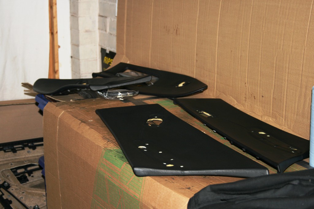

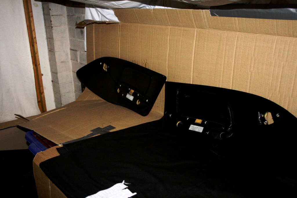

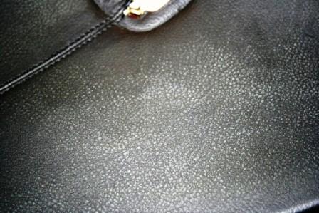

Panzer007 Posted July 20, 2010 Author Report Share Posted July 20, 2010 Ok so I didn't get to start the applying the dye....but I did get started and it took me just over three hours to prep the door panels. Started off by applying the Pristine Clean which cleared the leather of extra dirt etc and then went straight in with the prepping agent: I then used 600 wet & dry with blue roll to mop up the mess: This picture shows untreated on the left and treated on the right: Difficult to judge when to stop but basically when the paper towel stopped lifting lots of dye: All 4 ready for dye Link to comment Share on other sites More sharing options...
