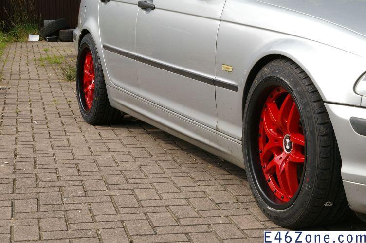

Dr T Posted April 11, 2013 Report Share Posted April 11, 2013 i dont think there's any magic here, its just two things, firstly the tyres are massive, i'm running a 205 on the front to make this offset work secondly you're ride height is just too high, the hub moves in an arc as the suspension moves through its travel, so as you go lower the tyres tuck more. even this low left mine poking a bit but at this height they work, Link to comment Share on other sites More sharing options...
