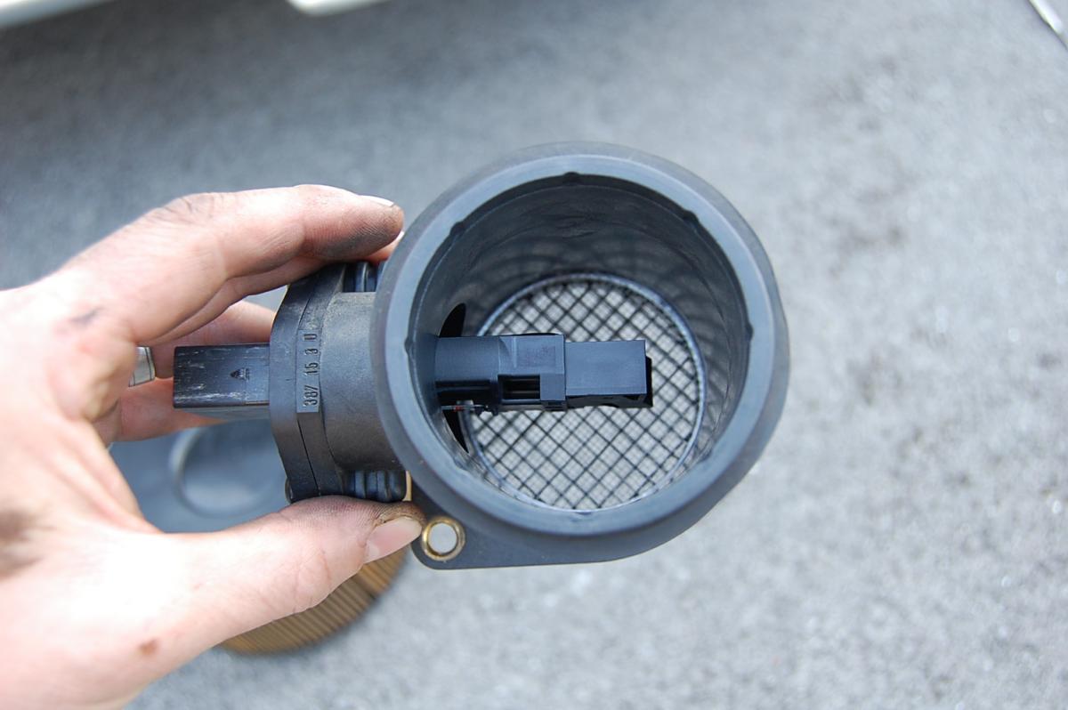

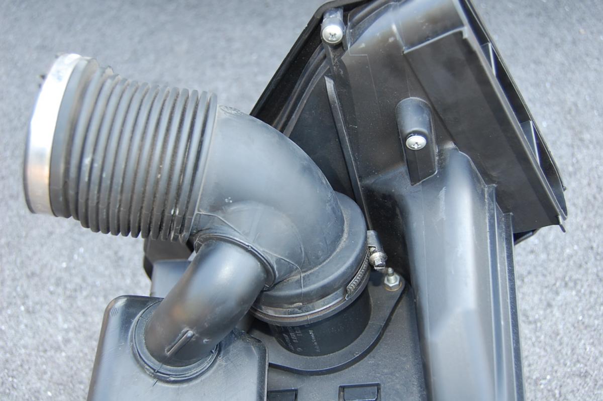

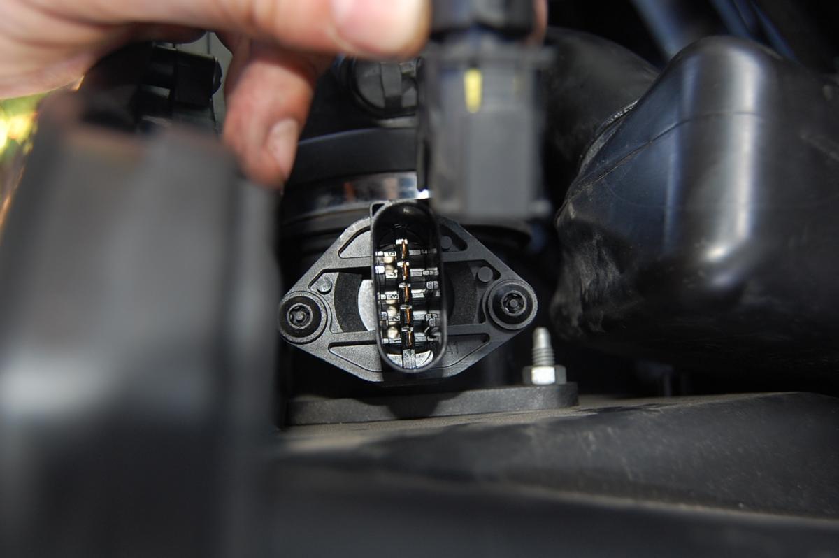

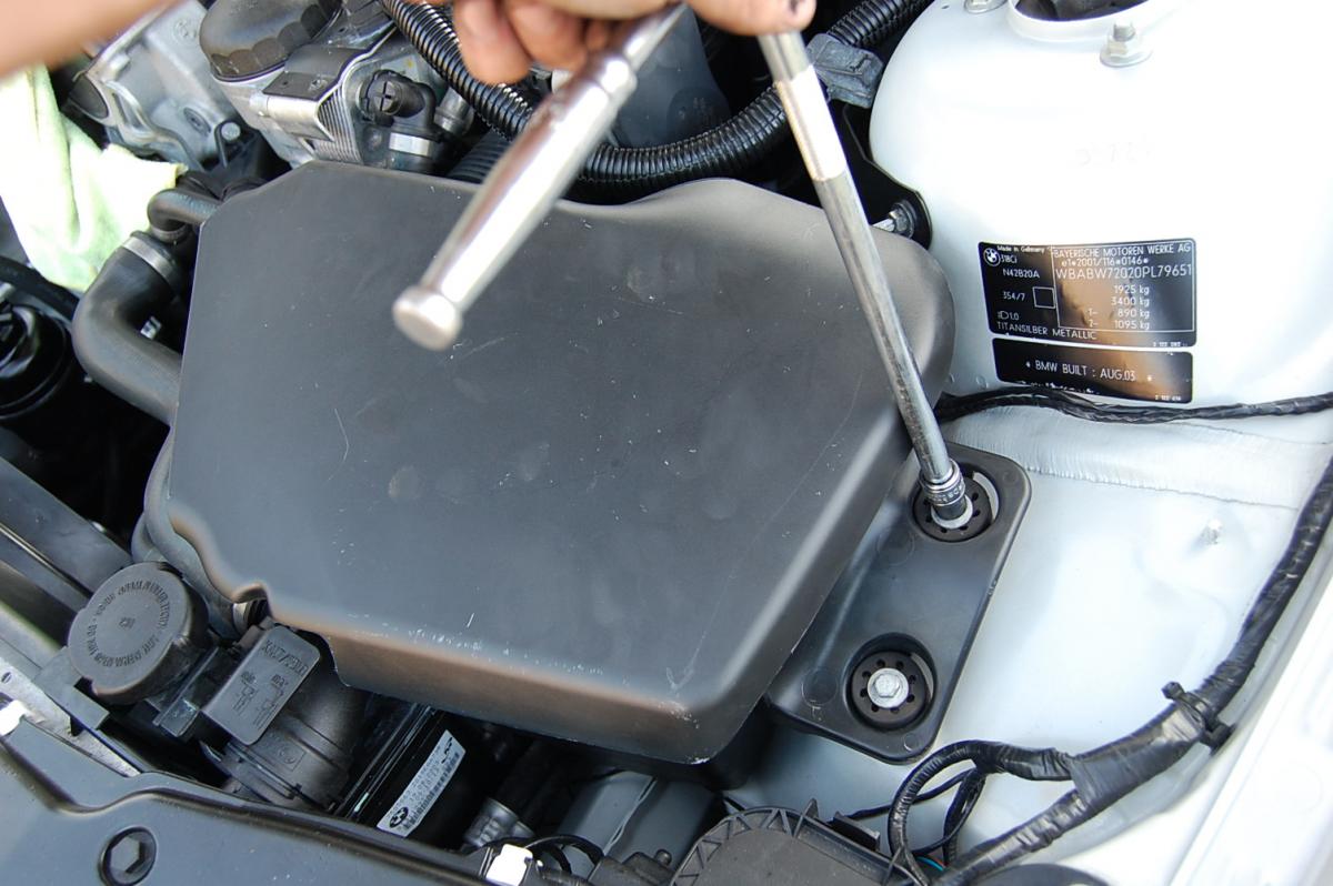

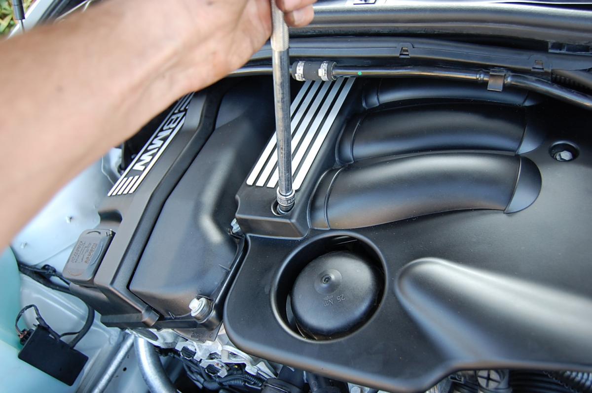

David Posted September 20, 2008 Report Share Posted September 20, 2008 Just finished changing my air filter and as there are no DIY's anywhere for my model thought i would do one myself. Our engines differ from all the other DIY's I've seen for the air filter so thought i would post this. Hope it helps. 1. Remove the cover with the BMW badge on it. See pic 1 2. Remove the top cover. See pic 2 3. Remove the two hex bolts holing the filter housing. See pic 3 4. Unscrew the jubilee clip and pull back the pipe. See pic 4 5. Pull the small pipe off the housing. See pic 5 6. Remove the MAF sensor plug by pushing in the two lugs and pulling. See pic 6. 7. Loosen the jubilee clip and remove the pipe. See pic 7 8. Remove all screws holding on the lid. At this time you can see the filter but can not remove it yet. See pic 8 9. Remove the two hex nuts holding on the MAF sensor. Pull the sensor away from the housing. See pic 9 10. The air filter can now be removed and replaced. 11. This could be a good time to clean the MAF with the proper cleaner. 12. Replace in the reverse order. Easy ashandger 1 Link to comment Share on other sites More sharing options...

dondino Posted April 5, 2009 Report Share Posted April 5, 2009 I don't understand well the step 4.. about the jubilee clip... do you have a better pic where I can see it? Thanks Link to comment Share on other sites More sharing options...

scrimja Posted April 1, 2010 Report Share Posted April 1, 2010 Just finished doing this. What a TOTAL PITA! Getting the pipe off (step 4) was a total ball ache! Think I have made 2 small puncture marks in the pipe. Going to wait and see if any issues occur because of it. I'm glad that's over and done with for a long while! Not sure if you're still about David, if you are, thanks a lot mate! Link to comment Share on other sites More sharing options...
