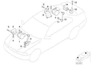

Tymm Posted August 21, 2012 Report Share Posted August 21, 2012 (edited) when you turn the ignition on do you here a motor if you do then you need to get under it drivers side LCA (wishbone) and there should be a little plastic arm number 5 is what you´ll need to fix, they always get broke when people forget to disconnect it when changing the LCAB look here also http://www.realoem.com/bmw/showparts.do?model=BN11&mospid=47615&btnr=31_0409&hg=31&fg=05 Edited August 21, 2012 by Tymm Link to comment Share on other sites More sharing options...
