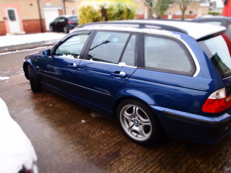

Thundercat Posted January 26, 2016 Report Share Posted January 26, 2016 Just after a bit of advice on what to do about spacers guys, basically i fancy spacing my rears out a bit to give it a slightly fatter look, thinking maybe 20mm each side. I thought it was just a case of buying a metal disc with the holes in the right place, taking the wheel off, and putting in back in with said disc between the wheel and hub! Had a little look online and i've just read a whole bloody article on it and now i'm confused as hell! Is it really that complicated or what? I've got Style 68s on my 320d which hasnt been lowered, if thats relevant. Link to comment Share on other sites More sharing options...
