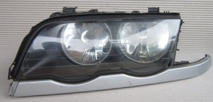

Riley707 Posted April 6, 2019 Report Share Posted April 6, 2019 Hi Ive just bought a 325ci 2 days ago and im not sure if the current headlight setup is legal This is NOT a picture of my car, dont have one to hand as its having work done. But ill try to explain it.....See Picture The previous owner i believe was halfway through putting xenons in. The Inside light (left bulb) is factory, and the outside light (right bulb) is Xenon. Which means i have 2 different colours projecting from either side of the car. so my question is.... will i be getting pulled over with the current state, or will i need to upgrade the factory bulbs to xenon.... or downgrade xenons to factory. Cheers Link to comment Share on other sites More sharing options...

Daz 330 Cs Posted April 6, 2019 Report Share Posted April 6, 2019 You’ve kind of answered your own question, xenon bulbs in a reflector headlight is a epic fail, it’s a shocking thing to do as the light is scattered all over the place. It also dazzles other road users as you’ve discovered. Either fit genuine projectors or take the xenon bulbs out. It’ll fail an MOT as they are currently. Link to comment Share on other sites More sharing options...
Riley707 Posted April 6, 2019 Author Report Share Posted April 6, 2019 Cheers, yeah I knew it wasnt right. I've actually had them sorted while it's been in the garage today so all is good. The other guy wasnt on the road just a random guy walking by lol. Thanks for the advice bud Link to comment Share on other sites More sharing options...
