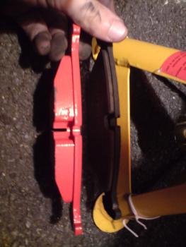

simonlpearce Posted October 22, 2008 Report Share Posted October 22, 2008 Ok so i got hold of a pair of EBC Redstuff brake pads from Ebay for about £60, here is my DIY on how to fit. This will work for most brakes regardless of model/engine size etc! Now before you start please remember that your brakes are a crucial part of your driving and although it is fairly straight forward to fit new pads, it is also easy to make mistakes and it could potentially lead to a very bad outcome! You will need 1) Set of decent spanners or socket set 2) Allen Key Set 3) Jack and Stands 4) New pads 5) Some copper grease 6) Flat head screwdriver and or pliers 7) Large G-Clamp (Very Large) So to start you will need to loosen the nuts on the wheel as it will not be possible whilst the wheel is in the air as it will just spin when you try to undo them. Next you need to raise the front of the car and place on Jackstands, this may not be as easy as you think as there are only certain places you can support the vehicle. I also only did one side as i needed the other Jackstand as you will see. Once you have removed the wheel in question and placed out the way, the first thing you need to do is remove the Caliper Spring. To do this simply place the flat head behind and lever it out, you can also use the pliers to help. It is a little tricky and can ping off so keep eyes etc turned away or you could be hurt. The next thing you need to do is remove the caliper allen bolts which are found on the rear of the caliper and are covered by a piece of rubber with a cap on, see pic below. As i didnt have the correct size allen key i decided to simply remove the carrier with the caliper attached. To do this there are simply two bolts holding the whole assembly to the hub, these took a little persuasion to actually undo. Now to actually remove the assembly from the hub you will need to wind back the piston as it is likely there will be a lip around the edge of the disc stopping you from taking everthing apart. To do this you will need your large G-Clamp - place one side on the back of the caliper (there is a flat part to rest it on) and the other on the pad which is facing you. Simply do it up and watch the piston crawl back into its hole . Link to comment Share on other sites More sharing options...
simonlpearce Posted October 22, 2008 Author Report Share Posted October 22, 2008 Now you should be able to remove the whole assembly including the caliper carrier from the hub and disc, this is where the second Jackstand comes in, use this to take the weight of the calliper as it is one heavy mo fo to keep hold of. Now before you go any further make sure you remove the brake pad wear sensor (only founf on the left side for front and right side for rears), it simply pulls out. Now you can remove the old pads so simply pull the buggers out, again i found the flat head came in good use here. The next picture shows the old and new pads side by side, what a massive difference you will see! Now fitting is pretty much a reversal of removal, grab your new pads and insert the one with metal prongs into the piston. If you have some put some copper greas on the side of the pad that has the metal prongs, this help to eliminate brake squeal. It may be a tight fit but it will go, just make sure you dont get your dirty finger all over the surface of the pad. The outer pad again needs copper grease on the side facing you, NOT the braking surface, but should be an easy fit. Replace you brake pad wear sensor, again it simply clips into place on the top of the pad. Link to comment Share on other sites More sharing options...
simonlpearce Posted October 22, 2008 Author Report Share Posted October 22, 2008 Now you should be able to refit the caliper and the carrier around the disc, then replace the 2 carrier bolts you removed earlier, or the allen key bolts if you went down that route. Lastly remember to replace the spring that you removed from the start of the proceedure. Now at this stage it is well worth checking you have tightened everything correctly and that you have actually reaplced everything as it should be, i cannot stress how important this is as it could potentially be your life in your hands, and more importantly the lives of others!!! Lastly refit the wheel and do up the bolts as tight as you can, lower the car off the stands, then finish off tightening the wheel once on the ground. Here is a pic of the end result.... Now before you get over confident and move onto the other side, go and check the level of the fluid in the reservior as it will be higher than it was as the pads are thicker then what you had on. You will need to have plenty of room in the reservior as you will also be winding back the piston on the other side so it will raise again. Just keep an eye on this and remove with a turkey baster if needed. Once the other side is complete before you go for a spin make sure all fluids are at the correct level after depressing the brake a few times. You should notice it bottom out the first few presses but it should go solid after a while. Now all you need to do is bed the pads in so around 500-1000 miles should suffice. I can honestly say im well chuffed so far with the redstuff pads, people say they do not work from cold but this is not true. They work equally as good as OEM pads when cold so no worries about not being able to stop when driving normally. I have not yet had a chance to get them up to heat but will report back on the performance when i have. Oh BTW i forgot to mention i went for redstuff instead of greenstuff as i have a track day coming up at Oulton, so should see how good they are then. Link to comment Share on other sites More sharing options...

DeePhee Posted September 14, 2010 Report Share Posted September 14, 2010 This isn't the correct way of doing it - especially the photo where the (very large) g-clamp is being used to push against the disk and the caliper. The caliper-slide pins need to be undone first, using a 7mm hex key (allen key, in plain english). To access the slide pins, pull off the black plastic caps at the back of the caliper, there you will see (or feel with your fingers, as it's out of view) where to insert the 7mm hex key. Undo the two bolts using the hex key, this makes the slide pins come out part-way, and then you can just pull them out. Once the slide pins are withdrawn, you can pull off the caliper and the pads with it. Withdraw the pads from the inside of the caliper. NOW you can push back the piston, but you can (and should) use a much smaller g-clamp than the above write-up. Make sure you've loosened the cap on the brake fluid reservoir in the engine bay first, so that when you push the caliper piston back in, the fluid has somewhere to go. Prepare the new pads by smearing copper grease on the back and also on the side "wings" or "ears", as these bits slide along the caliper and the metal-to-metal contact will cause squealing if not greased. Insert the pads into the caliper, making sure on the piston side the clip goes into the piston. Put the caliper back onto the hub and reinsert the slide pins (once you've smeared the smooth sides of the pins with some more copper grease). Tighten the slide pins with the 7mm hex key and reinsert the plastic caps over the slide pin access point. All done. Link to comment Share on other sites More sharing options...
