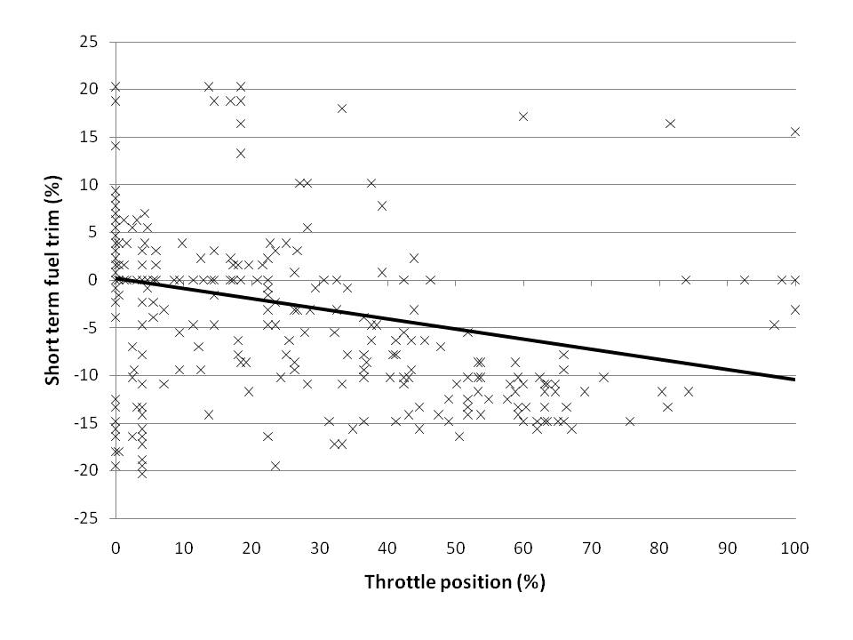

Nherb Posted June 22, 2011 Author Report Share Posted June 22, 2011 Hi, I believe a bit closer to fixing this... touch wood! The garages that I have been to have always read out a code that they interpret to be a potential air leak - and as a result I've had half the engine out checking ALL the tubes for leaks etc but have never found anything remotely suspect! At the time I found it hard to believe it was an air leak as it has always seemed to be running a bit rich to me. Anyway, finally the other day I got so sick of the light being on I decided I'd invest in my own cheap diagnostic interface just to knock the light off. I bought an ELM327 scanner on eBay (£15) - Don't want to get drawn into a discussion re: peake vs ELM scanners. I am VERY happy with my ELM, cheap; does the job; and allows me to log data such as throttle position, air flow, fuel trims etc.... I would reccommend this. HOWEVER, I can see the advantages of a Peake - I would certainly buy this if I could afford this. Anyway, I got my scanner and stuck it on my 318i: error code read p0170 (fuel trim malfunction bank 1). And indeed having logged my fuel trim using my ELM I can see that the long term trims are at: 20.4 & 30.4 for banks 1 & 3 respectively - too high I believe?! I also noted that I had pending codes related to the MAF and the air intake temperature sensor. Having cleared these codes since, p0170 has resurfaced numerous times, but the pending ones have never been logged since. Having checked the air intake temp information the car is getting it doesn't seem that there is a fault with this sensor. Bit more tricky to check the MAF data though I guess. So suspect a bad/dirty MAF sensor at present. Am planning to clean my MAF in the next few days, so will let you know how that goes. Anybody else have any ideas regarding this in light of the new info? Thanks Link to comment Share on other sites More sharing options...

Nherb Posted August 8, 2011 Author Report Share Posted August 8, 2011 Hi guys, Sorry to ressurect this thread, but thought I would let you know that I have now sorted my p0170 code! Turns out it was a lazy MAF sensor... As I was on a tight budget I didn't want to change this without being absolutely certain that it was the problem. I managed to diagnose the faulty MAF using my ELM327 scanner with scanXL software, which is able to record live data. I had thought that the MAF was ok in the past as it corresponded well with the engine RPM and I had given it a good clean. But after replacing crankcase breather and all associated tubing & checking entire intake tract for air leaks I turned my attention back to the MAF / fuel delivery system / pre-cat lambda. Although mine was a long-term fuel trim problem I used the short-term fuel trim readings to diagnose. I basically ran the car whilst recording throttle position & short-term fuel trims, expecting that the fuel trims should stay within +/-10%, they didn't! See the graph below... as I asked the car to go the lambda always seemed to ask for more petrol, yet it seemed fine at idle - figured it couldn't be an air leak then - progress! But, it have been MAF fuel delivery or a lazy lambda - so what I did was disconnect the MAF and then run the car under the same conditions again - this was conclusive; see below. A completely opposite trend. It had to be the MAF as the fuel trims under load were negative, the fuel system was delivering easily enough fuel, and the lambda was realising this fact. So I got myself down to Euro car parts, bought a Bosch MAF (they did me a deal for £160ish), stuck it in and recorded again.... see below - sorted! Checked my long-term fuel trim and it's back at zero for the first time in a year! Ver very happy indeed! I have read a lot of posts with people wanting to test their MAFs, but have never come across anyone suggesting how this can be done... Is this way a feasible way of doing so on the cheap? My scanner only cost me £15... reckon this could be quite helpful for a number of people! Link to comment Share on other sites More sharing options...
