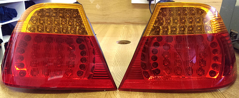

Jon.G Posted July 3, 2014 Report Share Posted July 3, 2014 I've never seen genuine amber LED's before. I'm guessing these are mega rare? Link to comment Share on other sites More sharing options...
Cannockwolf Posted July 3, 2014 Author Report Share Posted July 3, 2014 they took some finding, but the dealers can get them in 10 days, i got one from ireland and the other is enroute from germany luckily both new Link to comment Share on other sites More sharing options...

Cannockwolf Posted July 4, 2014 Author Report Share Posted July 4, 2014 Matching pair, thats a pair of brand new led's for £135 including delivery, result! Now to get that last clear one X-Man 1 Link to comment Share on other sites More sharing options...
Jon.G Posted July 4, 2014 Report Share Posted July 4, 2014 Great deal! Cannockwolf 1 Link to comment Share on other sites More sharing options...
Jon.G Posted July 4, 2014 Report Share Posted July 4, 2014 (edited) Do you have any information on what is needed to convert a pre facelift to have LED tail lights? I can't seem to find the information anymore Genuine LED's as well, not aftermarket. Edited July 4, 2014 by Jon.G Link to comment Share on other sites More sharing options...
Cannockwolf Posted July 4, 2014 Author Report Share Posted July 4, 2014 here you go mate http://www.e46fanatics.com/forum/showthread.php?t=933391 basically you need the led lights side gasket inner light cover plate conversion leads (from bmw) then you need to code your lcm, if your unlucky to have a lcm you cannot code then you will need to buy a newer one but then you will need to code the lcmn to your car so you dont get a tamper dot on your mileage Link to comment Share on other sites More sharing options...
Jon.G Posted July 4, 2014 Report Share Posted July 4, 2014 Perfect. Thanks! Cannockwolf 1 Link to comment Share on other sites More sharing options...

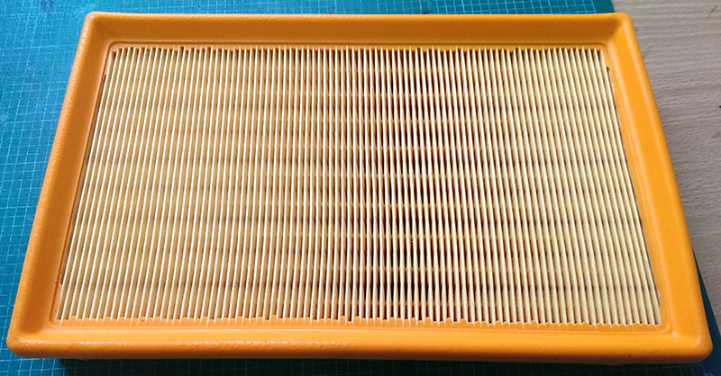

Cannockwolf Posted July 7, 2014 Author Report Share Posted July 7, 2014 Air filters turned up Link to comment Share on other sites More sharing options...
pirate1066 Posted July 7, 2014 Report Share Posted July 7, 2014 Brill you won't have to filter your home brew through your socks now Cannockwolf 1 Link to comment Share on other sites More sharing options...
