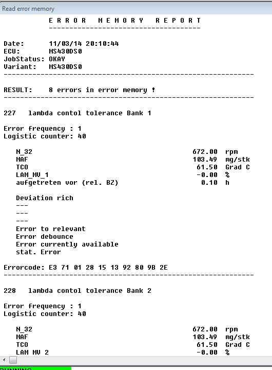

robster330ci Posted November 3, 2014 Author Report Share Posted November 3, 2014 I have attached some pictures of fault codes i read this evening. Appreciate any help! Link to comment Share on other sites More sharing options...
pete_h Posted November 3, 2014 Report Share Posted November 3, 2014 Check your intake boot for any splits robster330ci 1 Link to comment Share on other sites More sharing options...
robster330ci Posted November 4, 2014 Author Report Share Posted November 4, 2014 Hi, thanks for the suggestion. I have just checked all the rubbers, and no splits. Link to comment Share on other sites More sharing options...
