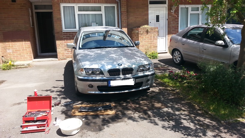

Alexander0 Posted June 6, 2015 Author Report Share Posted June 6, 2015 (edited) Thought I'd update the thread. I managed to swtich the bumpers sucessfully yesterday. It was a little more hastle than I had hoped, but overall not too bad. I can confirm that it is a straight swap for a pre-facelift to a Mtech1 (Aero) body kit bumper- with a few minor caveats (see below). There were a couple of points where I wondered whether it was, but with a few added steps, it is. NB this is not for the Mtech2 msport kit, apparently there are a few differences for that swap. First of all, for a comparison, here are the two parked next to each other. Here is the end result on my car. I much prefer it, although the bumper probably could have used a respray. ------------------------------------------------ I thought I'd take time to post up in more detail the process, just to help out any future newbie like me who may be interested in doing the front conversion. The video posted earlier in this thread gives pretty decent instructions. You just have to undo the two outer most srews in the wheelwell liner, the 4 bolts and 2 plastic plugs under the very bottom of the bumper and then the two large retainer bolts under the front of the bumper. I found I caused less damage to paint if you unscre the number plate holder (2 screws) and then use that to pry up the side plastic bumper trims. The resistance I was feeling upon a second look was the plastic liner of the wheelwell which the bumper curves around / overlaps at the side. So it is easier to gently pry the lining out so before trying to take the bumper off. Remember to take care when removing as there are 2x horn and 2x foglight connections that need to be undone before you can lift it off completely. If you buy one with the carrier, then it would be just bolt on and go. If like me, you need to switch the bumper carrier over, then there's a little more work to be done. 1) Undo all the plastic rivets holding the bumper onto the carrier. If you are careful you can preserve these for reuse: gently use a flat head screw driver to pry up the central core, and then pull it out with pliers. There are also two bolts to be undone from the front. Then remove the divets fron the 3 retainer tabs on the underside (or top) of the carrier. Finally you need to remove the 4 plastic rivets that secure the fog lights to the carrier. The easiest way to do this is by removing the fog light (pry fron the inner side of the light on the SE bumper) and then you can get access to the rivets from there. Then all that is involved, is this in reverse except for a few small caveats: (A) You have to remove this plastic bolt guide from the carrier - the Mtech bumper has one inbuilt. B The plastic plugs (that secure the bumper to the carrier) have a different fitment position on the two bumpers, but the carrier has the correct holes that allows for both. The SE has 3 that are positioned as below: The Mtech1 has 4, but if you put the carrier in the bumper it should pretty clear where they should go. Edited June 6, 2015 by Alexander0 TriggerFish 1 Link to comment Share on other sites More sharing options...
Alexander0 Posted June 6, 2015 Author Report Share Posted June 6, 2015 (edited) © It appears that the carrier bolts are a different size for the SE bumper and Mtech1. I haven't found shorter ones yet, but I'll post up the part number/source when I do. (D) You'll need the numer plate holder specific for the Mtech 1 (although it should come with the bumper) because the bottom screws are different from SE to Mtech1. . That's it, from what I can remember. I don't know whether I'll bother to do the rear - I actually think I prefer the SE bumper, and the Mtech one I have is in pretty poor condition. Maybe I;ll get around to it. Edited June 6, 2015 by Alexander0 Link to comment Share on other sites More sharing options...
