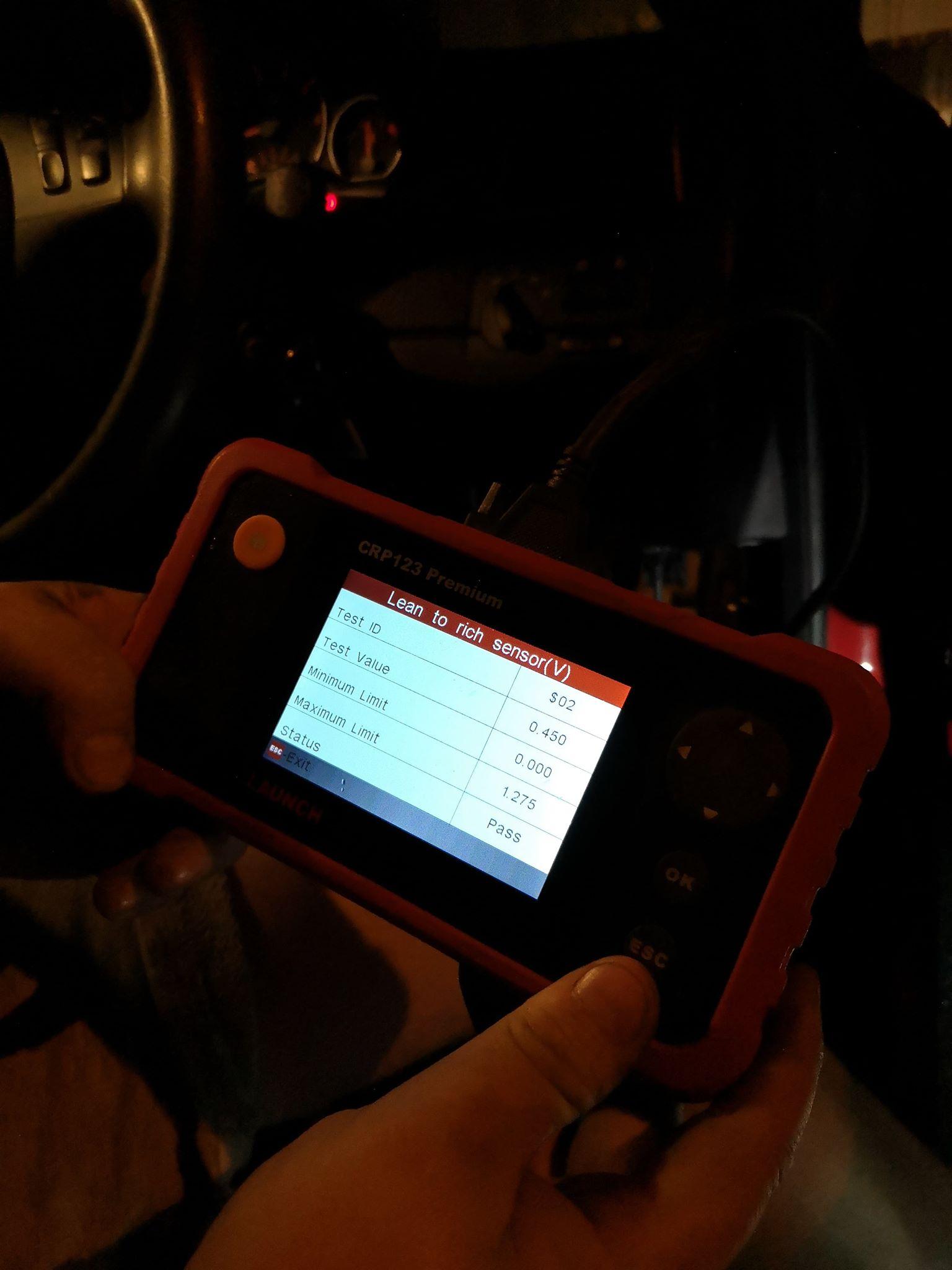

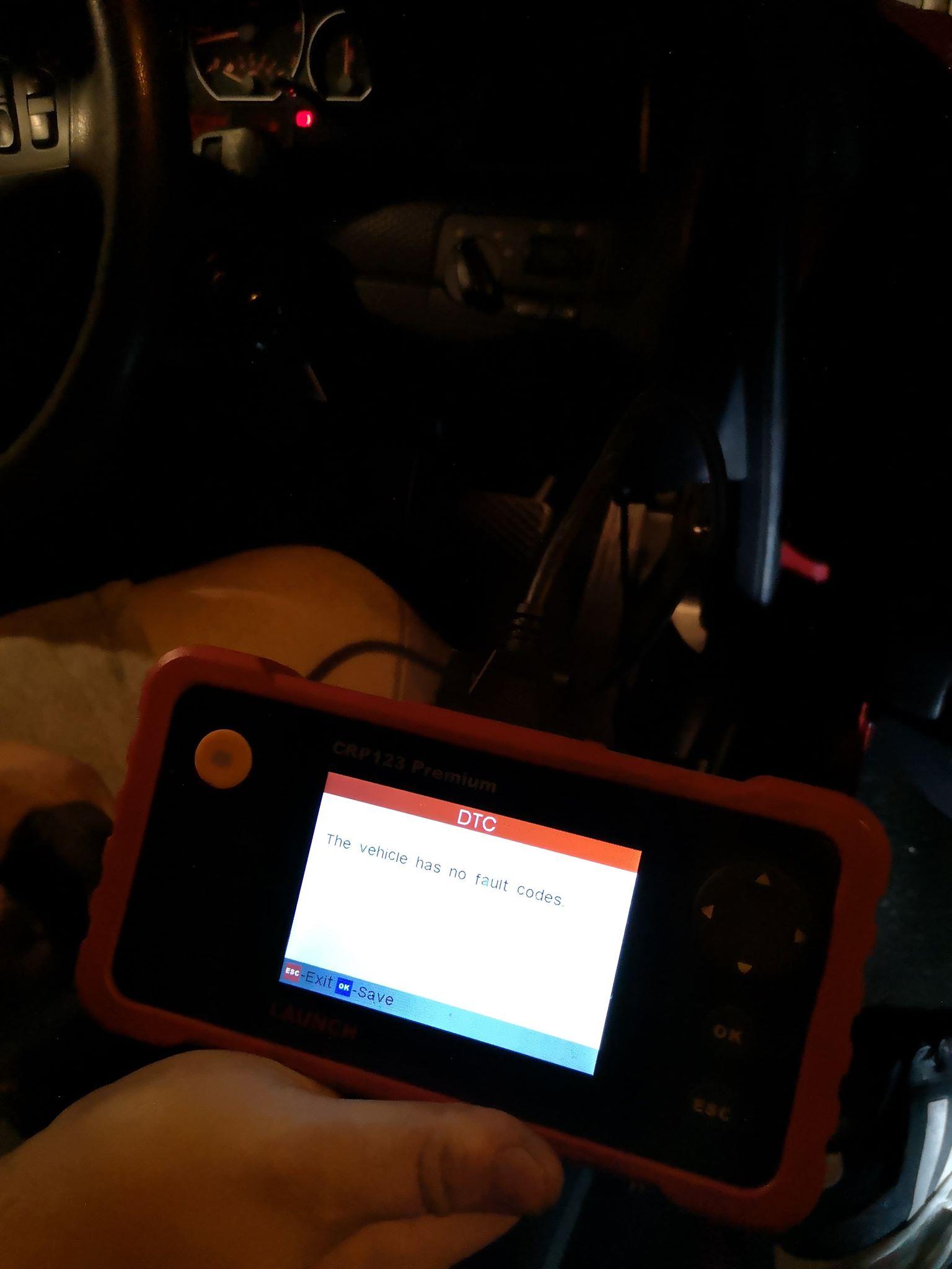

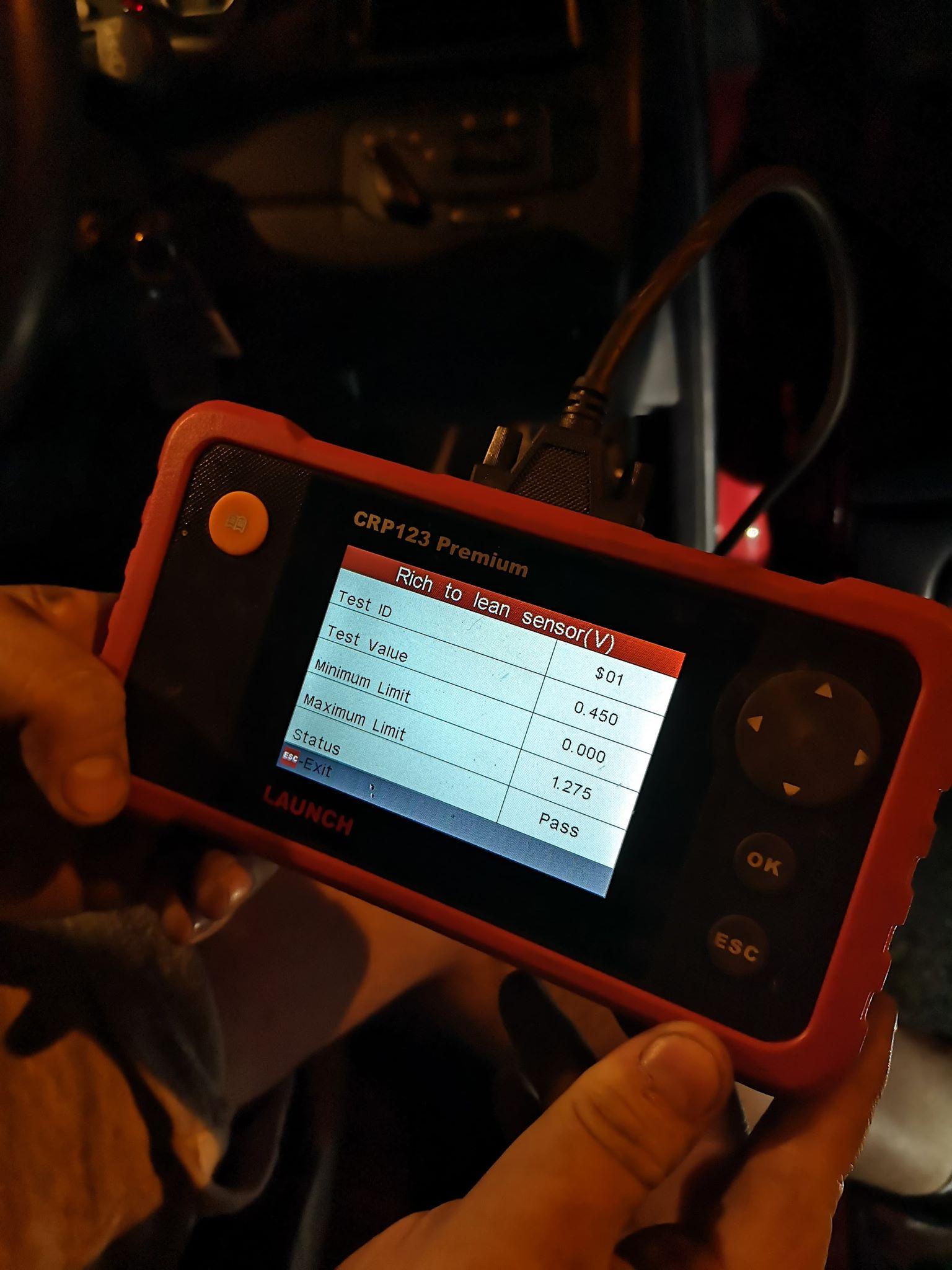

Viking Posted October 31, 2019 Author Report Share Posted October 31, 2019 "mechanic said sometimes when it is intermittent like that it can be a matter of cleaning the sensor rods. He did that and the engine light is gone! " So i spoke to the seller again and he ordered a Air mass meter that turned out to be to small, but as quoted above his mechanic cleaned the sensor rods and the check engine light is gone.. i have also attached the test results below of what the mechanic was reading. The seller has offered to replace the part as his cost either before purchase (or after if it comes back), although the check engine light is now gone so changing the part seems kind of pointless to me. Anyone willing to shed some light on this? Should I go for it or be a bit more cautious regarding this? Thanks for the knowledge and help!!! Link to comment Share on other sites More sharing options...
