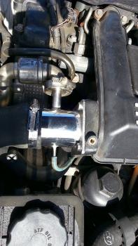

The_Judge_ Posted April 18, 2014 Author Report Share Posted April 18, 2014 Finished both of these jobs in the morning. There is an improvement, but my car is still rough idling but that's another story ... The job took longer than I wanted it too. Did anyone find that the EGR Bypass kit they used was not a perfect fit? I couldn't get it exactly into the right place, I basically only have two bolts in it of the 4, one bolt broke in half because of the pressure I put on it to force the kit to move to the left and the final bolt is only half in but rock tight. Basically the "blaocker" neck on mine was too far extended out from the body of the uni as can be seen in this pic: Final result: Link to comment Share on other sites More sharing options...
JasonK Posted April 19, 2014 Report Share Posted April 19, 2014 Could the rough idling not be because you have a dodgy seal between the EGR blank and the intake manifold, where you only have pressure on the top screws? Have you tried pushing it to make a deal while it is idling? Sent from my Lumia 1520 using Tapatalk Link to comment Share on other sites More sharing options...
momo Posted April 19, 2014 Report Share Posted April 19, 2014 How far off are the bolt holes? Can they be drilled to make the bolts go through and fit properly? Just sounds like a lower quality manufacturer tbh.. They've probably got measurements/jig to produce them and they're slightly out.. The quality of the product looks bang on to be fair! Link to comment Share on other sites More sharing options...

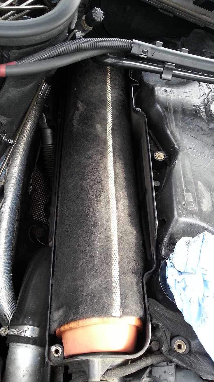

The_Judge_ Posted April 19, 2014 Author Report Share Posted April 19, 2014 (edited) It was severely rough idling before the job, my foot on the brake pedal was shaking at traffic lights. To be fair the idling has now decreased a bit since the job so i don't think it's related. A few months ago I discovered i had a leak in my injector return line. According to the service history the breather valve was replaced (but still to loo roll) a couple of years ago. My air filter is BLACK, i will take a picture of it! Many of the bolts for the engine covers are wrong and some are missing. So in conclusion i think whom ever the previous owner had do the valve replacement was a brute, they damaged the injector return line and fuel has been trickling out since then, (the damage was right next to the brather housing) I'm going to get a full service done next week and then i can check out the rough idling if it is still there. EDIT: after a day of lettering the bolts/pipes settle into the new position dictated by the kit, i took everything apart again to day and managed to force the gasket in today and put it back together again. Edited April 19, 2014 by The_Judge Link to comment Share on other sites More sharing options...
The_Judge_ Posted April 21, 2014 Author Report Share Posted April 21, 2014 Did I mention my air filter was BLACK ?? Like I said before, I think a botched breather housing/valve upgrade during the previous owners lifetime, inadvertently caused damage to the fuel injector return line resulting in a dripping of fuel to down into the breather and air filter ... Car is running a lot smoother now after fitting the bypass, new breather and new air filter. My MPG seems to be a lot better too Link to comment Share on other sites More sharing options...
TriggerFish Posted April 21, 2014 Report Share Posted April 21, 2014 Mine wasn't too far off that colour after 10,000 miles (or whatever the service indicator says). Still minging though! I managed to break that fuel return line myself when trying to remove the injectors. Can't imagine running the car with it not connected - that's pikey at it's highest IMO! Got a new whole line with all 6 nozzles for a tenner, but still a pain at the time. The_Judge_ 1 Link to comment Share on other sites More sharing options...
