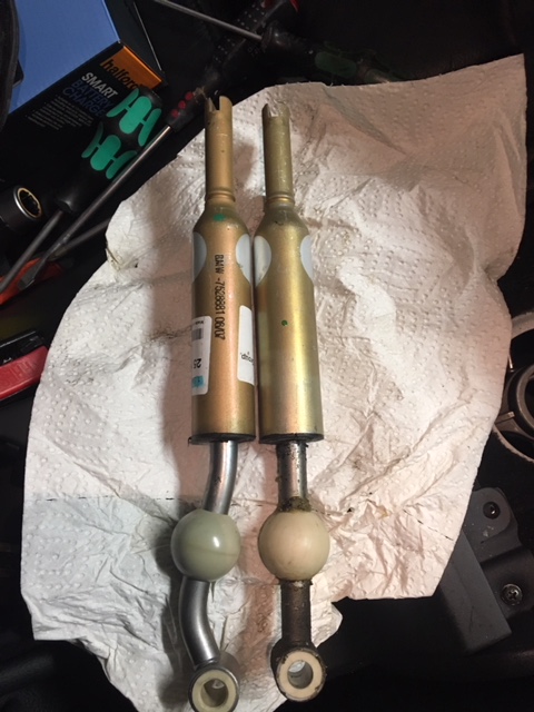

Id also stumbled across another thread on people looking for a short shift on the factory 6 speed boxes around the same sort of time.  Trawling through thread after thread of people recommending the 545i shift lever however common responses were that they arnt compatible with a 6 speed box for whatever reason. Finally after feeling like id gone full circle on it i found that ECS in America had kindly left a part number on their website for a factory short shift kit. “Apparently” the same as the bmw performance range. (Part N/O - 25 11 7 528 881). So the following say called the local stealer and got a price of £56 for the lever. Along with ordering a ZHP knob and a new shifter bush and clip I thought ive got to have it. (Short shift is the curved one on the left)

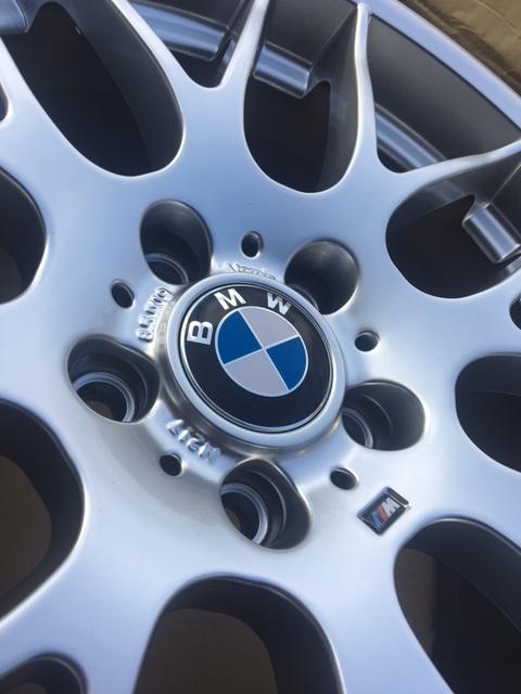

Next on the lost was a set of CSL alloys. The obvious choice for a 46 in my eyes. Overplayed or the perfect factory wheel? I went for the latter and decided on the highest quality and closest copy to the original wheels. Looked at a set of apex arc-8s and decided they were too track orientated for what i was after and after speaking to bm autosport picked the best quality ones they offered a staggered set of atomic csls in hyper silver. 8.5j et38 fronts and 9.5j et45. Wanted the highest rear offset available in order to have a car full of passengers if i needed to. I they decided on another set of pilot sport 4s 225/35/19s and 235/35/19s. Originally I picked the 255/30s for the rear but Michelins come up very wide and after having them fitted they were huge. Almost a 265/275 tyre. The 235 is only mildly pulled onto the wheel and after giving the car an extra -0.5 rear camber can confirm it can run 4 people without any noises whatsoever.

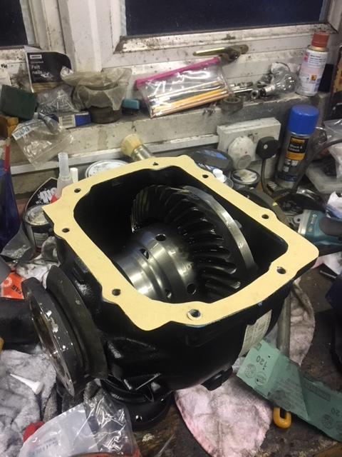

The quaife..... i looked into various LSDs. Rebuilding a 288 case LSD from an early e36 328 sport and having it built into my casing, buying a Drexler clutch slipper and a wavetrack or a quaife helical. Again after many hours of weighing up what would be best for the car I swayed more towards the helical type LSD. The little to no maintenance being one of the big reasons and the fact that the quaife is one of the more forgiving units out there. Doesn’t lock in and out aggressively and wont try to kill me if i get it wrong. Again just wanting to sharpen the car up not make it full on “motorsport”. Plus knowing who Birds were and the products they produced with the same quaife l units fitted to m235is and various other bmws etc I thought it had to be the best product available. (Fingers and toes were crossed that I wasn’t going to have any issues like the eisenmann and that “forum talk” actually held its weight this time). I called up James at Birds and placed the order. I also cannot stress enough that if anyone is looking at building one of these units buy new bearings. My original diff and car at this point had only covered 27k and the bearings were/ are still in great shape however removing them to refit to the new unit was near on impossible. I didn’t have the luxury of some of the specialst tools that Birds have available to remove them. Aside from that the unit itself building into the case was fairly straightforward and came with a step by step how to guide. Id also stumbled across another thread stating that a Z4 rear finned diff cover woukd fit being as the diff casing was the same unit used on the 46s.... So once again i was on the phone to the stealers to put one on order. Cant see a LSD however the finned cover was the only small nod to the diff being slightly different. Thoughts.... grip is just exceptional now. DSC doesnt even flicker. Car is more planted and almost feels like its being pulled around corners. Can honestly say if youve a spare £1200 buring a hole in your pocket buy one. Night and day difference.

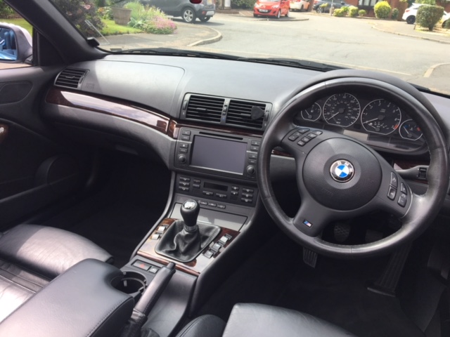

Inside the car is your usual looking interior. Ive fitted a new relocation panel along with a new handbrake surround and removed the stock bmw business CD player and fitted a Dynavin N7 unit to pull the interior up to date. Wanted an oem looking unit that didn’t require any fettling to fit. (Love and hate the wallnut dash! Was original so left it in)

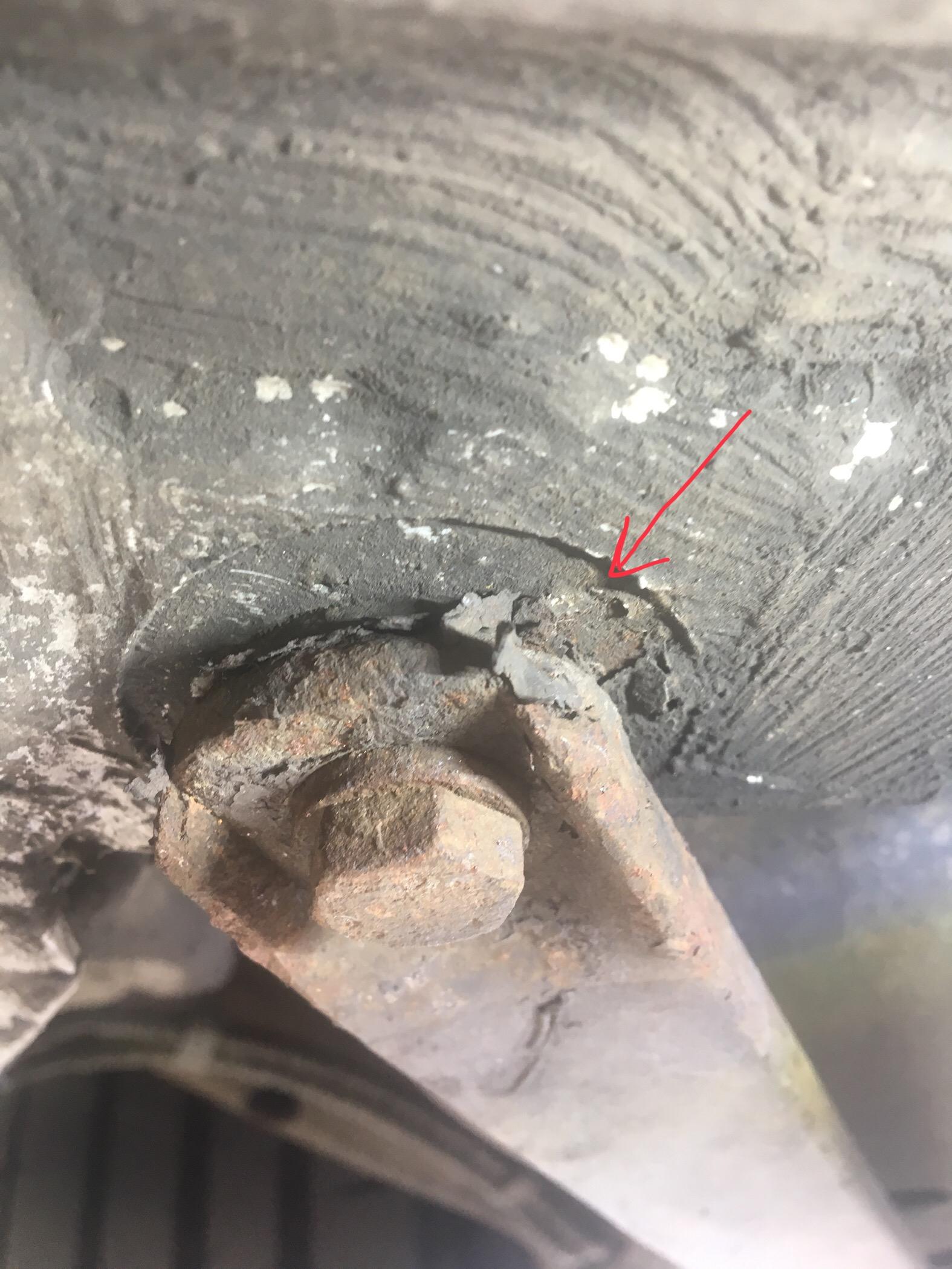

So.... Managed to book the car in with redish motorsport to have the comprehensive check carried out on it. The car on the travel down there clocked over 30000 miles ☹️ and averaging 37mpg on the trip down there! Still with having the check carried out it would give me a good detailed idea with the condition of the car after 15 years of age/a small amount of use and mainly storage. After what seemed a lifetime of nail biting I received the “list of doom” off Luke and James. They assured me that it was a very small list in comparison to alot of cars they see and all be it very minor issues. The subframe was also checked using their bore scope method and given the all clear and crack free which for that alone is worth the piece of mind.
I was highly impressed with redish. They were very polite and accommodating whilst i waited with the car. Ive added some pictures of the small areas they picked up on in the report of the rust they picked up. Eagle eyed springs to mind! (Excuse all the dirty waxoyl underneath the car!)
