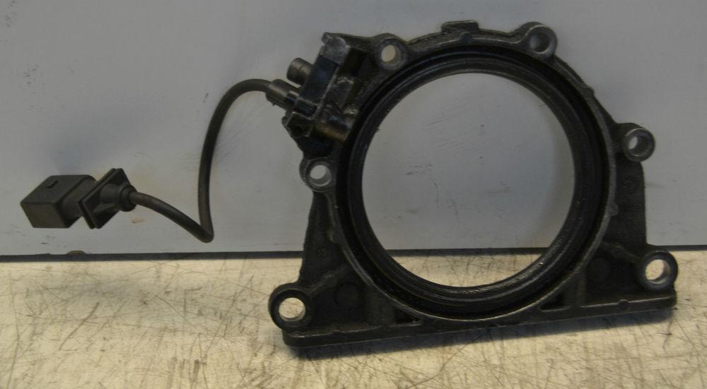

I notice that you've replaced the crankshaft sensor - is that something you did yourself or was it a garage job? I've got the part but haven't plucked up the courage to try and find the damn thing yet. Getting slow cranking issues, and every so often mine will take a good 10 seconds of cranking before she fires into life. Crankshaft sensor is the only code I keep getting back on INPA nowadays!

That's what I'm thinking at the moment, I can't see it from the top, and from the bottom will require lifting the car and getting the under trays and support brace off. Might have a quick look at the weekend when I'm due to do the shocks and springs and book it in if I can't.

I think the starter motor has to come out too, can't recall exactly now, but i think this picture may help location....

Thanks for that - I attacked it myself, and while I was there replaced my starter motor as it was coming out anyway. What a massive pain in the backside that job was. Haven't checked the codes yet but I think my starter was the thing causing the codes to come up. Having said that, it starts up instantly now, a huge improvement - thanks for the photo - it helped!
