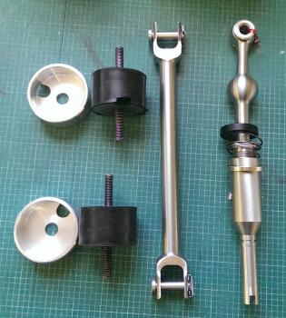

Cannockwolf Posted May 9, 2014 Author Report Share Posted May 9, 2014 (edited) Just arrived from the U-S-of-A, to go on the same time as the quaife lsd UUC Short Shift Kitd with DSSR Edited May 9, 2014 by Cannockwolf Gaz 1 Link to comment Share on other sites More sharing options...
